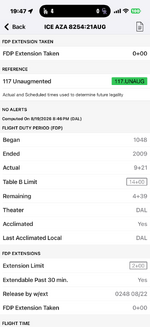

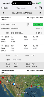

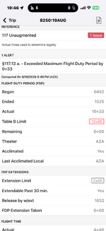

Hello,
Took an extension today (19Th), ending up with 33 min over duty limit..
20th will be a short travel day..
21st shows 22:38 rest, and still shows a 2 hour extension as YES..
If I am over 30 minutes on 19th (actual 33), I would need a 30 hours rest to reset an extension.. correct?
Just seeing APDL is looking at this correctly..

I believe you are correct as well.
Can you please send this to me through app so we may investigate this more in-depth.
In APDL go to menu...communications...report a problem.
I see your system has automatically closed the ticket .. just seeing that this is still a logged issue, you’re working to try and resolve
Be sure to keep TestFlight builds up to date, the issue is being worked.
Ok.. I am showing 15.1.0.0/54 on both iPhone and iPad .. went to test flight and it is showing 15.5.0 (15.5.0.1) .. it is showing I already have app installed.. I am assuming I should replace app version with latest test version.. correct?
